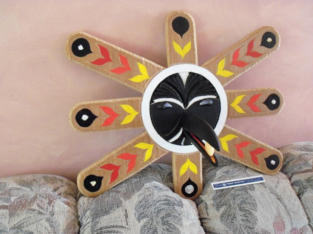

I use several brands: Stevenson, Binney, daVinci, Grumbacher and Windsor&Newton.
I am painting on dark brown western red cedar ( Thuja plicata ).
You can look at some of my carvings in the Showcase Section.
The colors do not show brightly over the dark wood.
So, I do a complete under painting with titanium white to mask the wood color.
Then the colors go over top of that. I do not need underpainting under the black.
