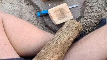

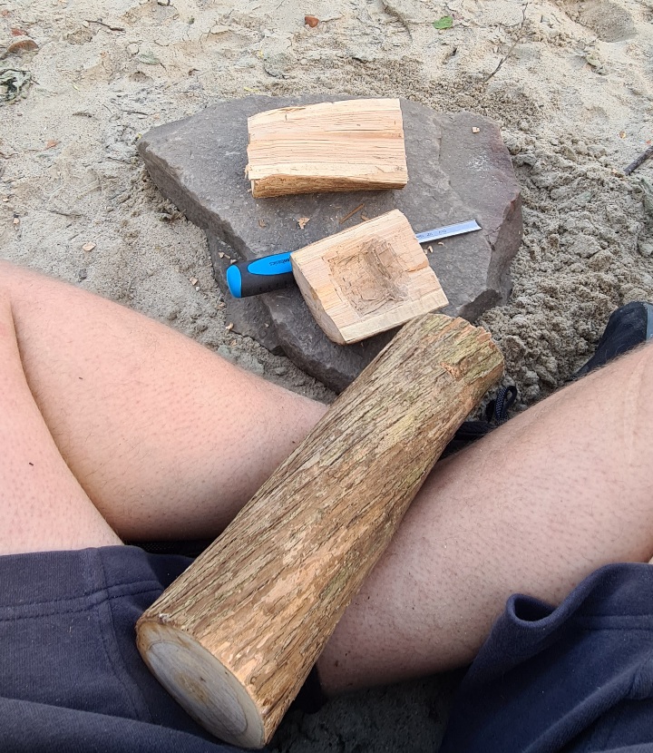

  • Outside, under some sort of cover, but not cooked in a shed, I expect wood to dry at a rate of 2.5 cm per year. Western red cedar and yellow cedar and paper birch don't crack very much except for the ends. I expect some losses so I cut these pieces off.
    Cut a wooden wedge from the back, the ugly side of the log, all the way down the center. This relieves a lot of drought stress. All totem poles are made this way, they are meant to be seen from one side and the other side is cut off to reduce cracks. Otherwise we will carve through the cracks and ignore them.
