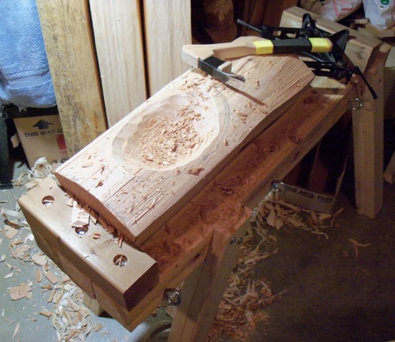

    I. have no lathe yet I carve dishes of several sizes.

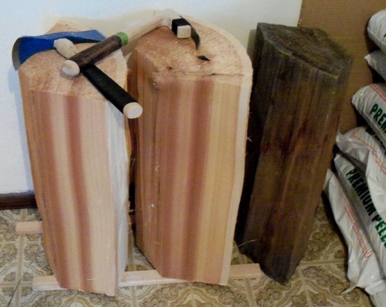

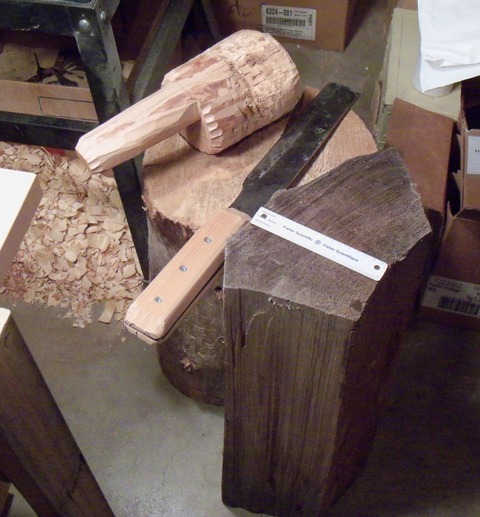

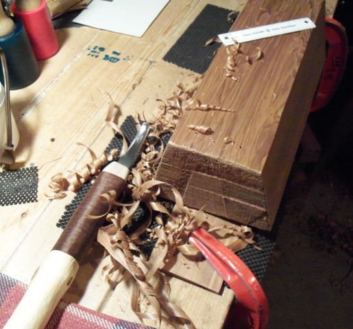

    The first thing to do is to select some wood. These shake blocks are western red cedar.
    The fresh and colored ones weigh about 18kg, the old weathered block is dark brown and maybe 10kg.
    They are 60 cm tall and split to follow the grain with no knots whatsoever.
    The old block needed to have clean surfaces and end cracking sawn off to maybe 45cm.

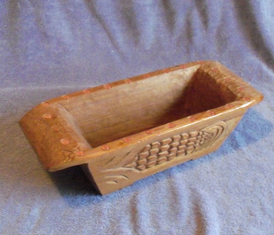

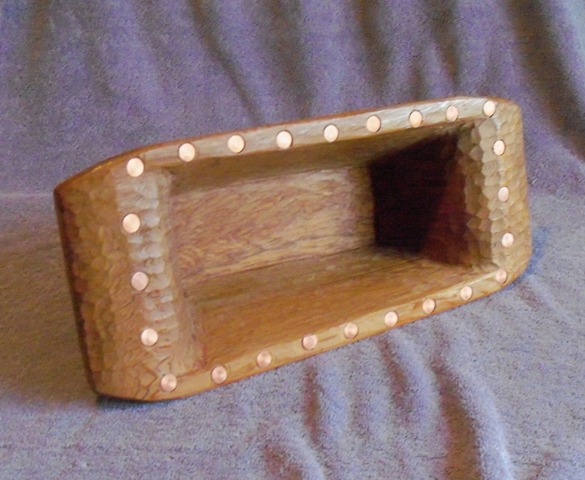

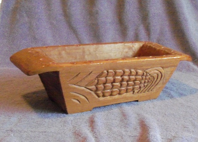

  • Eine schöne Schale hast Du geschnitzt. Das Holz sieht aus wie Eiche. Eine schöne ,saubere Arbeit ist das. Die Punkte auf der Oberkante, was ist das ?
    Ist das ein anderes Holz oder sind sie aus Metall ? Messing ?

    Rainer Berndt: The wood is the old block of western red cedar on the right side in the first picture.
    The dots you see are pure copper metal inlays made from the rivets used to assemble horse harness.
